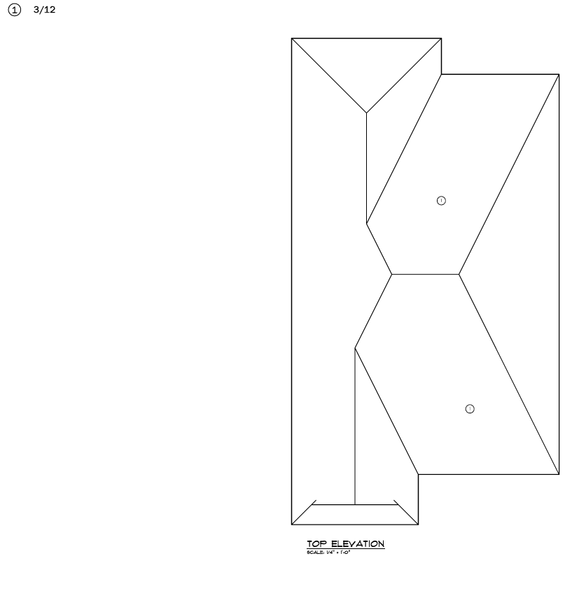

okay i got a two part question here for yall hopefully yall can help me out.

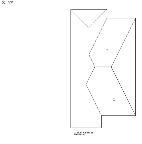

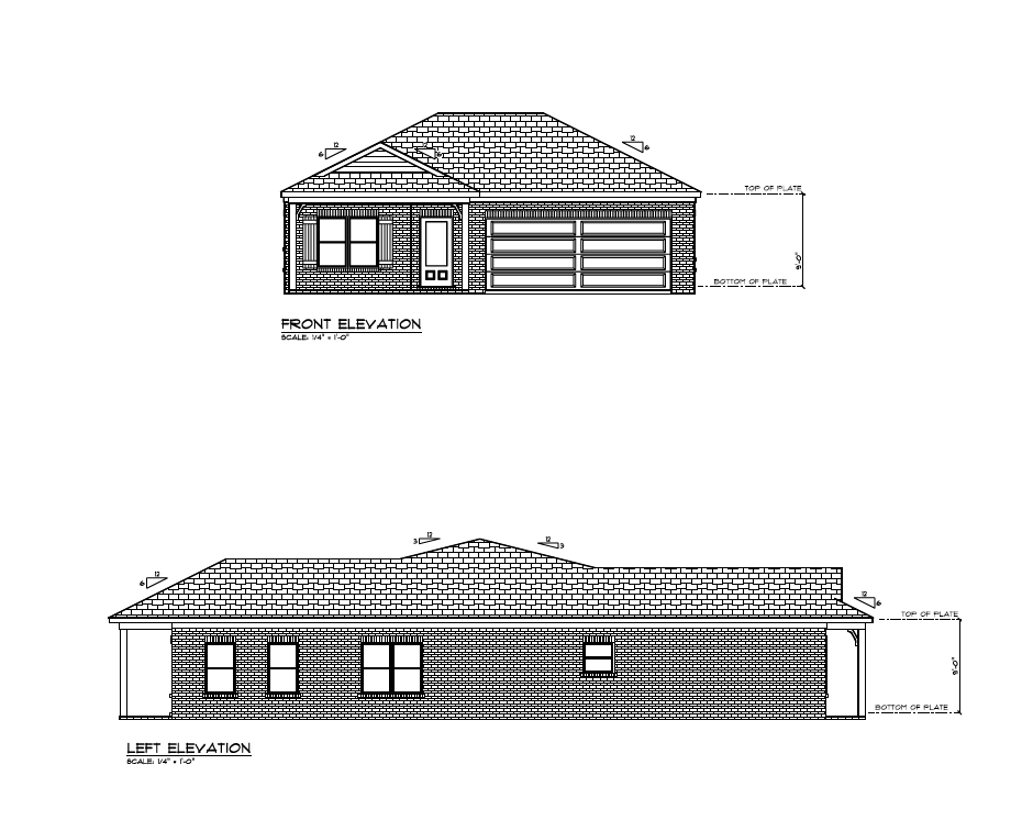

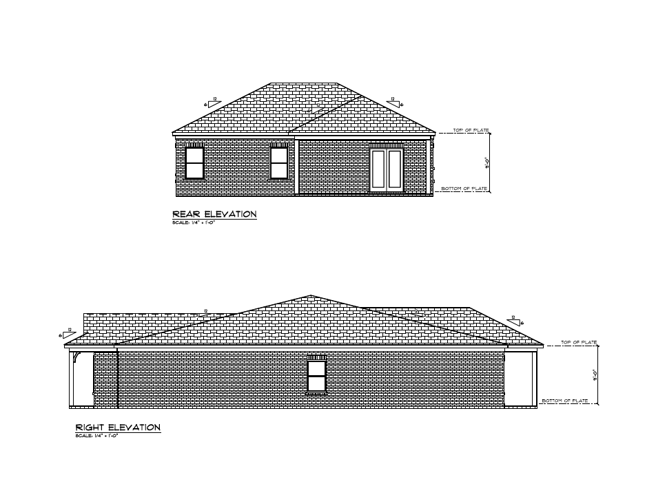

1.) im trying to create a trussed roof with different pitches however i am finding it hard to do so with the trusses themselves. is this possible similar to the “edit roof pitch/add gable” tool that lets you edit individual faces of a roof to the desired pitch if they vary form others if that makes sense? if not then is there another way I can achieve this?
NOTE THE ROOF FACES NOT LABELED ARE 6/12

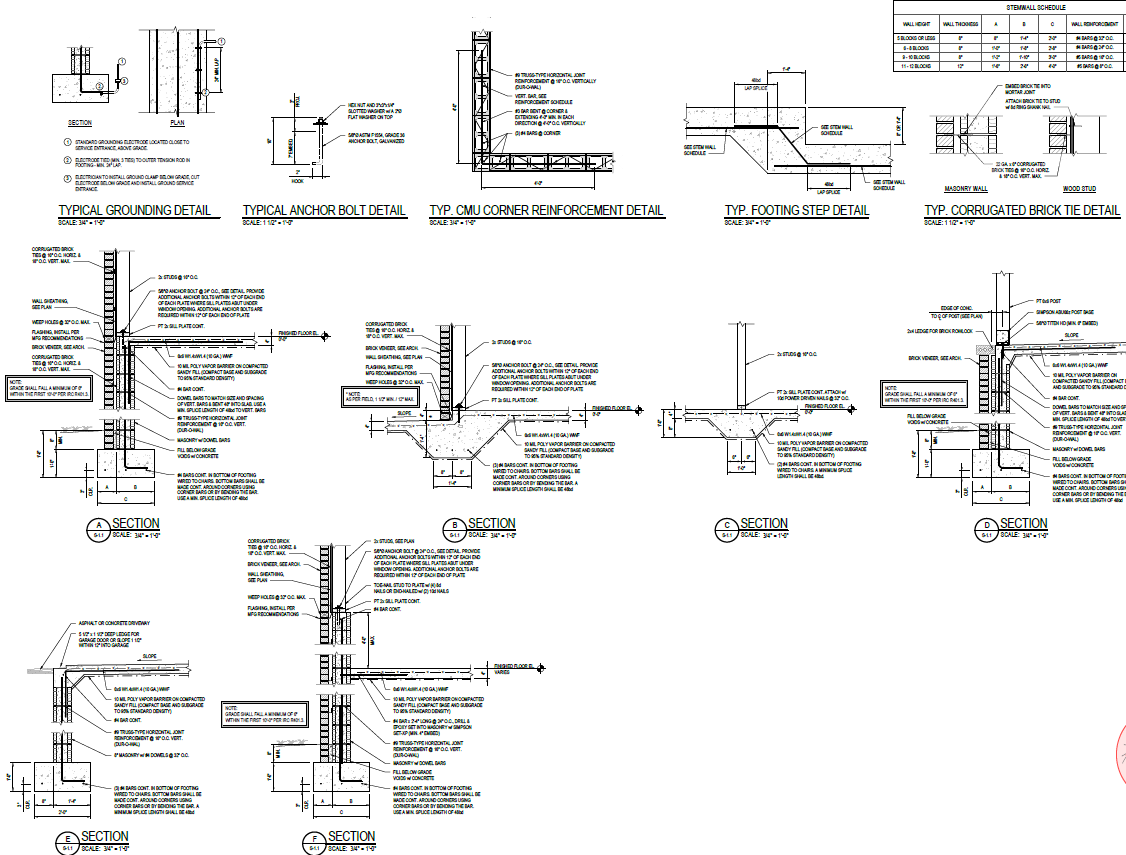

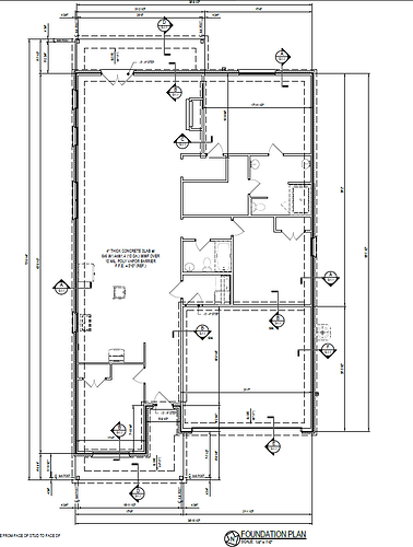

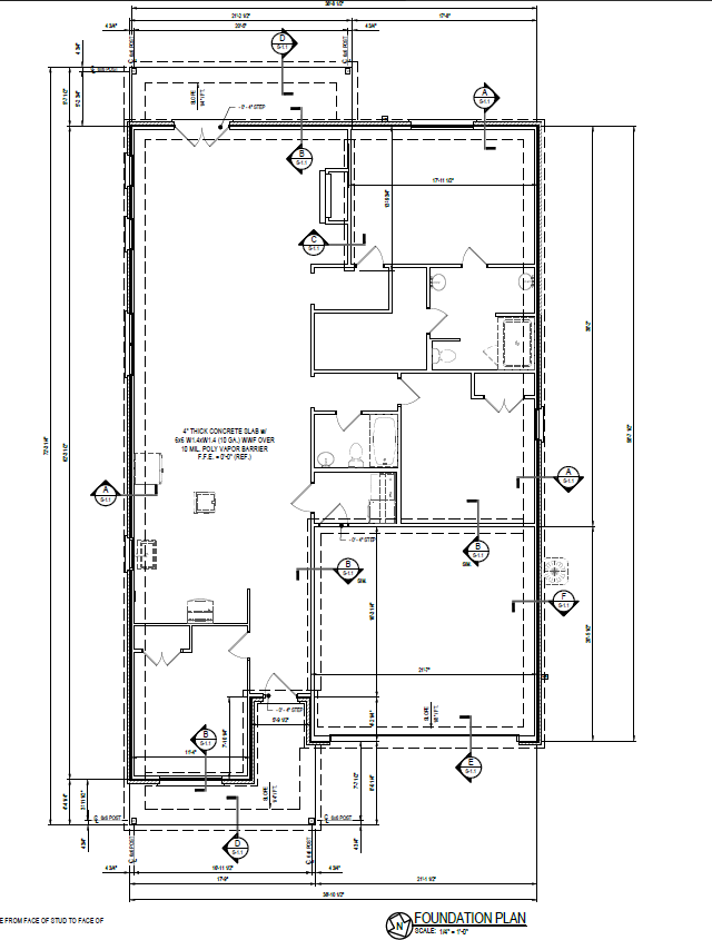

2.) I need to create a stem wall foundation since this house will need to be raised up but all I see is a footing tool…would I need to use the wall tool to create a stem wall and then add footings under said wall?

Trusses With Different Pitches
Currently the only way to create trusses with different pitches is to manually draw each truss & then use the BIM Tool to add the estimating info to it so it quantifies in the :takeoff_tool: Takeoff, then using the copy-move feature of SketchUp to add each instance of the truss at the required spacing. Tip: Add the estimation info to the truss before copying & pasting it.
Stem Walls
The best way to create stem walls is to enable footings when drawing the walls. The steps below outline how to do this.
  1. Open the :wall_tool: Wall Tool.
  2. Select your desired wall type (e.g. Solid Wall or Masonry Veneer) & specify the Wall Height & Header Height. Tip: The Header Height must be less than the Wall Height, so it’s best to make it a small value in this instance (e.g. 1mm or 1") as it’s unlikely openings will be in these walls.
  3. Navigate to the Materials, Selections & Finishes section & select your desired materials. Note: Use the Wall Thickness field if you’re using the Solid Wall wall type.
  4. Navigate to the Foundations/Footings section & tick the Include Footings?.
  5. Specify the parameters & material for the footings. Tip: Use Justify Footing to adjust how the wall & footing align with each other.
  6. Draw the walls as you normally would & you should now have some stem walls.
