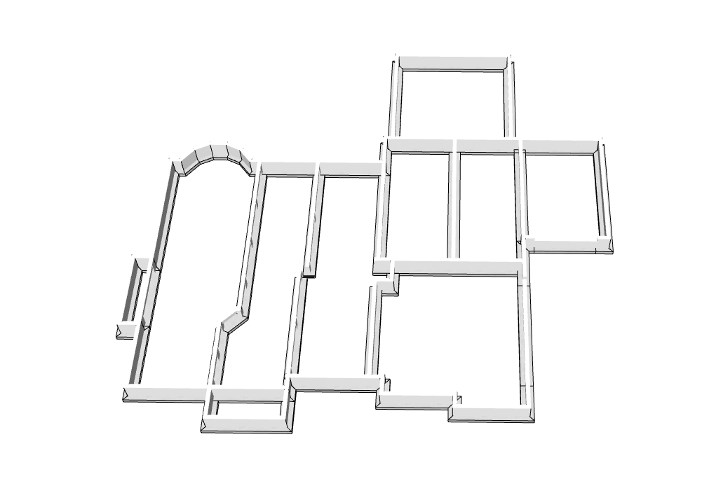

I am using plusspec to create a foundation with the wall tool. Select solid wall, 8”, include footing.
The footing shows up well, the solid wall is visible but lacks edges to snap to, appears white.

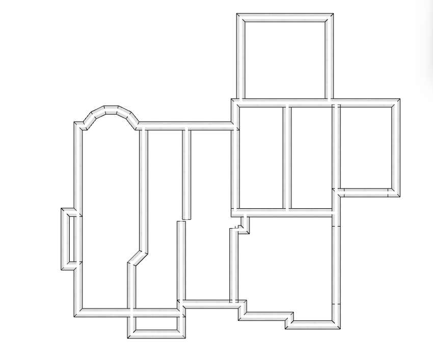

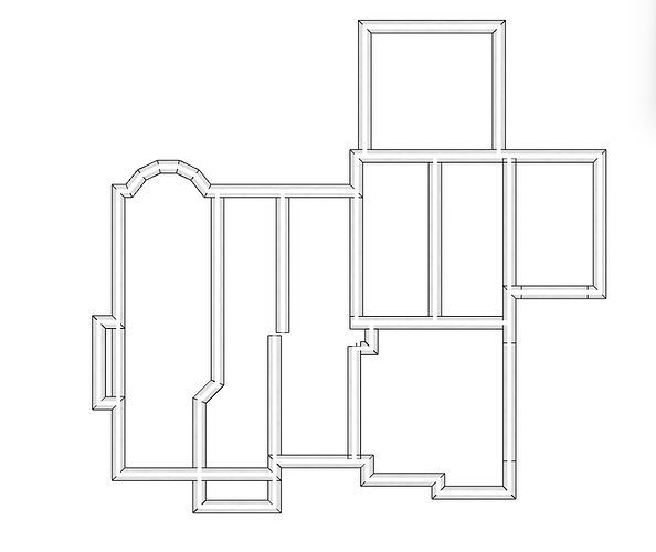

My end goal is create a 2d drawing in layout with visible footings, block walls. I have previous models that the same steps produced perfect results.
Having difficulty locating my error. I’ve used Ai to assist, but run in a circle with no succuss.
