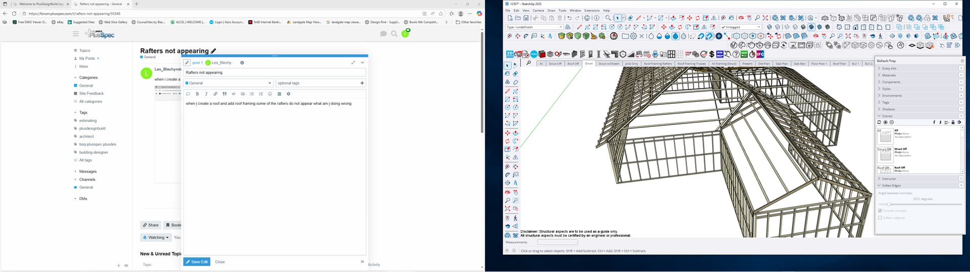

when i create a roof and add roof framing some of the rafters do not appear what am i doing wrong

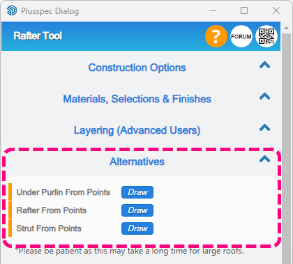

In the meantime, what I can recommend is to use the options in the Alternatives section of the :roof_framing_tool: Rafter Tool dialog to add the missing members.
Rafter Tool Alternatives Section

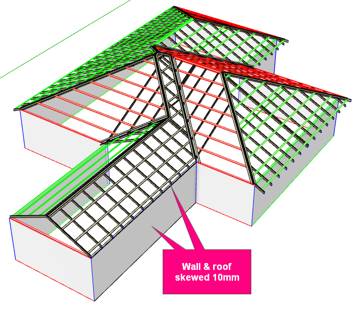

I did also notice that in your model there was a skewed wall which likley would’ve caused the roof to also have a skewed side. In the image below, the colour of the lines signifies what axis the geometry is aligned with. However the lines for the wall, roof & roof framing are black meaning they aren’t aligned with an axis, which may partly be contributing to the issue you’re having.

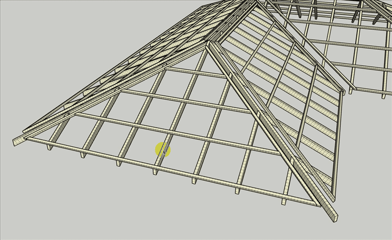

the rafters draw when i have an overhang but if i edit the roof to be no overhang using reverse jerkinhead the rafters do not draw

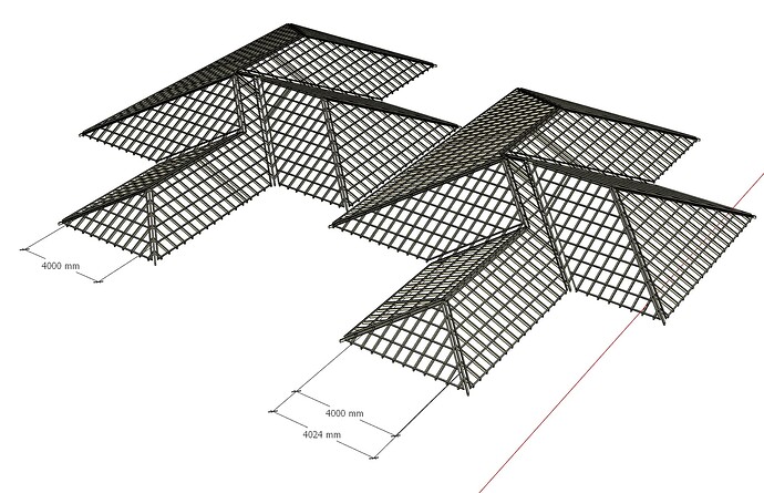

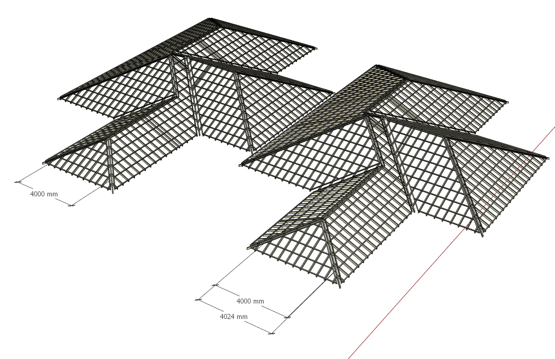

I’m Glad Grant is getting this sorted for you. By the way, what happens if you just select the one face and use the rafter tool?
I tried to replicate the issue on a similar shape/face, and it worked even when the wall was not parallel
