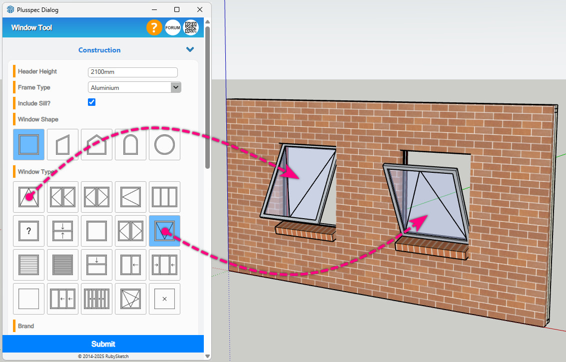

Hi Dave P,
It seems like you may have the wrong window selected. We currently have an awning window & a hopper window which look similar but open differently. If you change the window to the awning window option (first option in the list) it should be correct.
