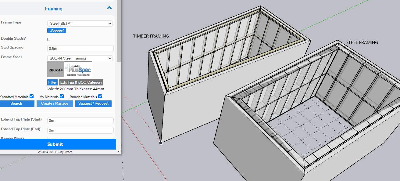

Is it possible to design/create framing structure in steel?
Hi, thank you for your post.

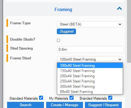

Yes, it’s possible to design/create a framing structure in steel.
In the Wall Tool & throughout PlusSpec you can create your own materials, so if something is missing that you want or need, you can easily create it. All you need to do is click the ‘Create’ button under the material field, enter the material info & either drag-and-drop the material or use the Sync Tool to get the new material(s).
Hope this helps. :slight_smile:
