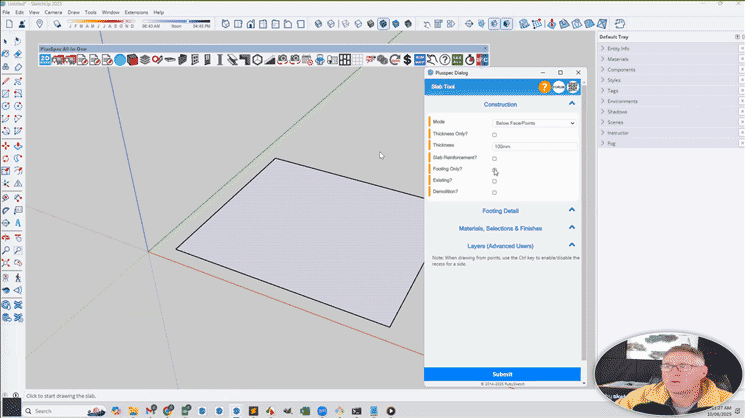

Hi Reece, I just thought of this workflow
Step footings creation using the slab tool
Here is a cheat GIF
