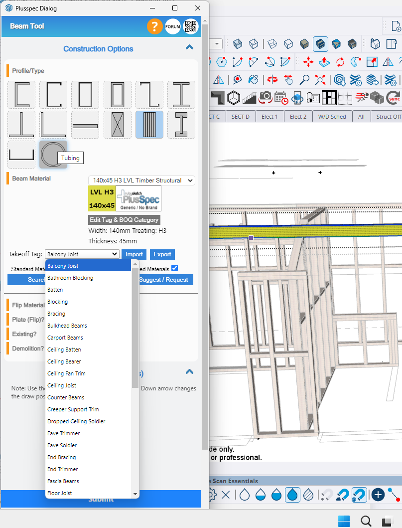

This might be a silly question, I can’t find any specific videos on editing the takeoff tags? I am building some custom frames and would like to label Stud, Bottom Plate, Top Plate etc… however I am not sure how to do this.
I have attached a screen shot for reference.
James

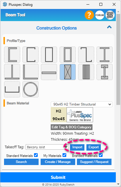

The options in the list can be edited via the Import & Export buttons located next to the Takeoff Tag dropdown field (circled in the image below). Select Export to create a CSV file with all the current options which can be edited in a spreadsheet editing program (e.g. Microsoft Excel). Select Import to locate the CSV file & update the option in the list.
Thanks Grant, I tried to do this by importing a list I made in excel. I will try exporting first and then reimporting. Appreciate the help.
