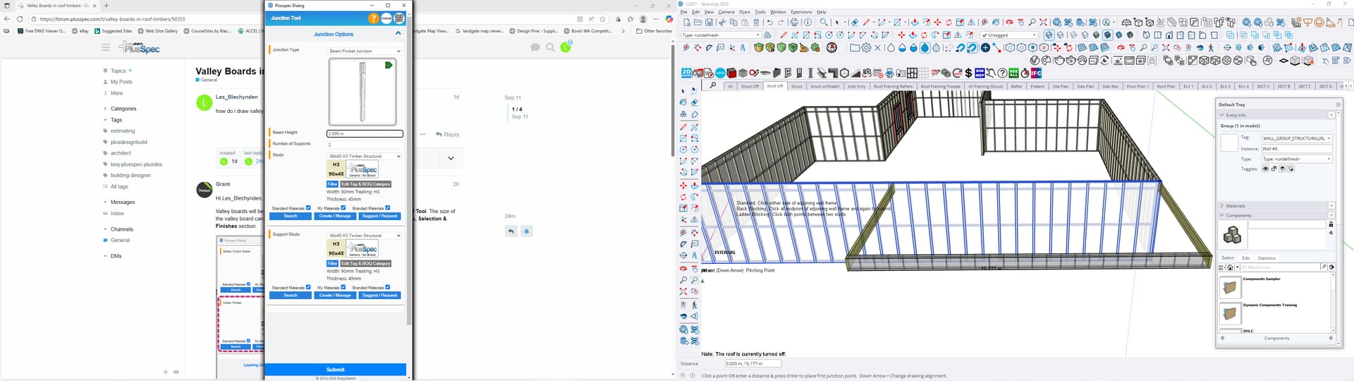

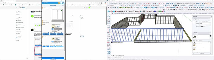

i cannot seem to get the beam pocket height to change from 2.00m any tips

I’m also getting this issue but I’m not sure what’s causing it (it’s very odd). Thank you for bringing it to our attention, I’ve passed it onto the develoment team to look into & fix. I’ll get an update released as soon as the issue has been resloved.
In the meantime, I would recommend drawing the Beam Pocket junction at the height it’s allowing & then manually adjusting the height & positions of the associated framing members to suit.
Note: This is a manual edit so it’ll be reverted if the wall is adjusted by a PlusSpec tool, so I recommend only making the changes towards the end of the project or when you know no further changes will need to be made to the main object (i.e. editing the wall via a tool).
