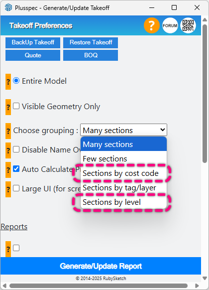

Im trying to find the advanced framing report, ive watched the videos and followed the steps but I dont have an option to tick the advanced framing report when I go through the take off preferences

Do you have either of the “grouping” options circled in the screenshot below selected? If so, the advanced takeoff pages currently aren’t available for these options.
