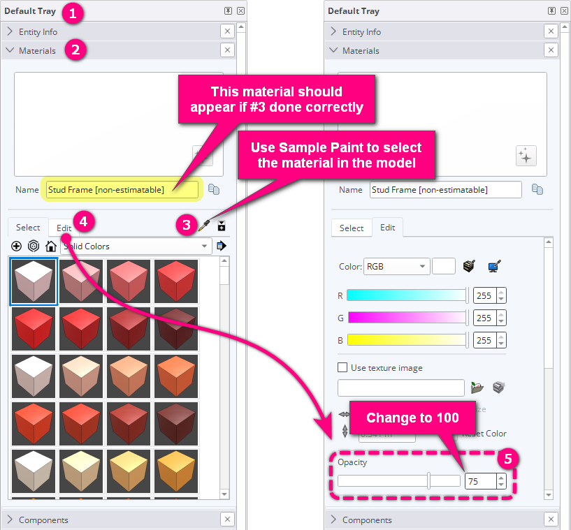

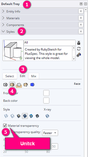

Currently, any wall I create appears as a tranparent solid. It impacts only the Framing layer (including battens) while everything else in the wall is appearing as it should.

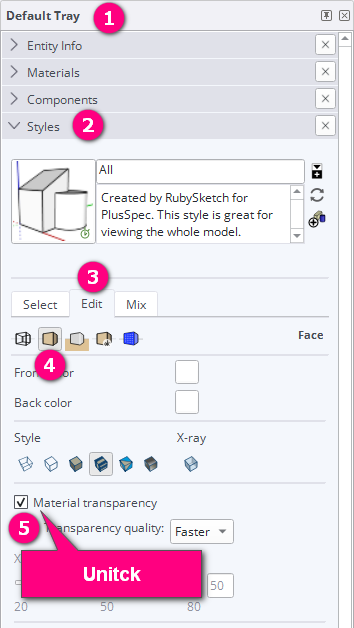

  • Option 1: Disable transparency for the acive style (located in Default Tray > Style under the Edit tab & Face Settings section). Note: This can be saved as a SketchUp template so it can be retained for future models, otherwise it’ll need to be done for each model.
  • Option 2: Change the opacity value of the material applied to the skin to be 100 (located in Default Tray > Materials under the Edit tab) . Note: This will need to be done for each model.
