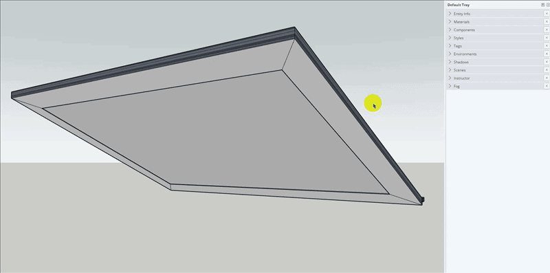

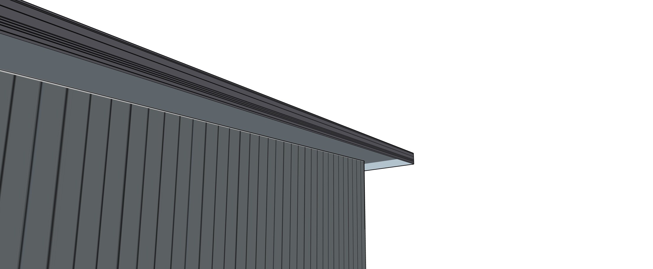

I’m designing a house with a single angled roof, but it’s causing me trouble. On the interior, the drywall only forms a rectangle, leaving exposed framing. Also, despite having the ceiling and soffit set to “raked”, the soffit won’t appear. Any help is appreciated!
P.S.: It won’t let me upload the second picture of the drywall

It sounds like the tags/layers for the ceiling & soffit linings are turned off. If you go to the Tags section of the Default Tray are 21_EAVES & 26_CEILING_LINING (under the 4 Roof folder) turned on or off?
Note: If you’ve created scenes using the :scene_tool: Scene Tool, the tag/layer may be turned off for the selected scene.
Ceiling & Soffit Lining Tags
Thank you! It was set to invisible.
If you’re ever in doubt, click the :see_all: button, it’ll turn everything on for you.
Also, ensure you use the :scene_tool: as this automates the visibility of tags, but note: Sketchup 25 has a built-in purge function that asks if you want to purge the model before saving. I suggest clicking no as this will delete tag folders that actually help you stay organised in the future.
