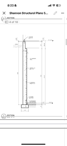

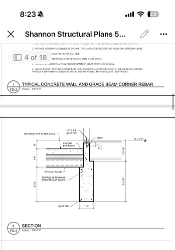

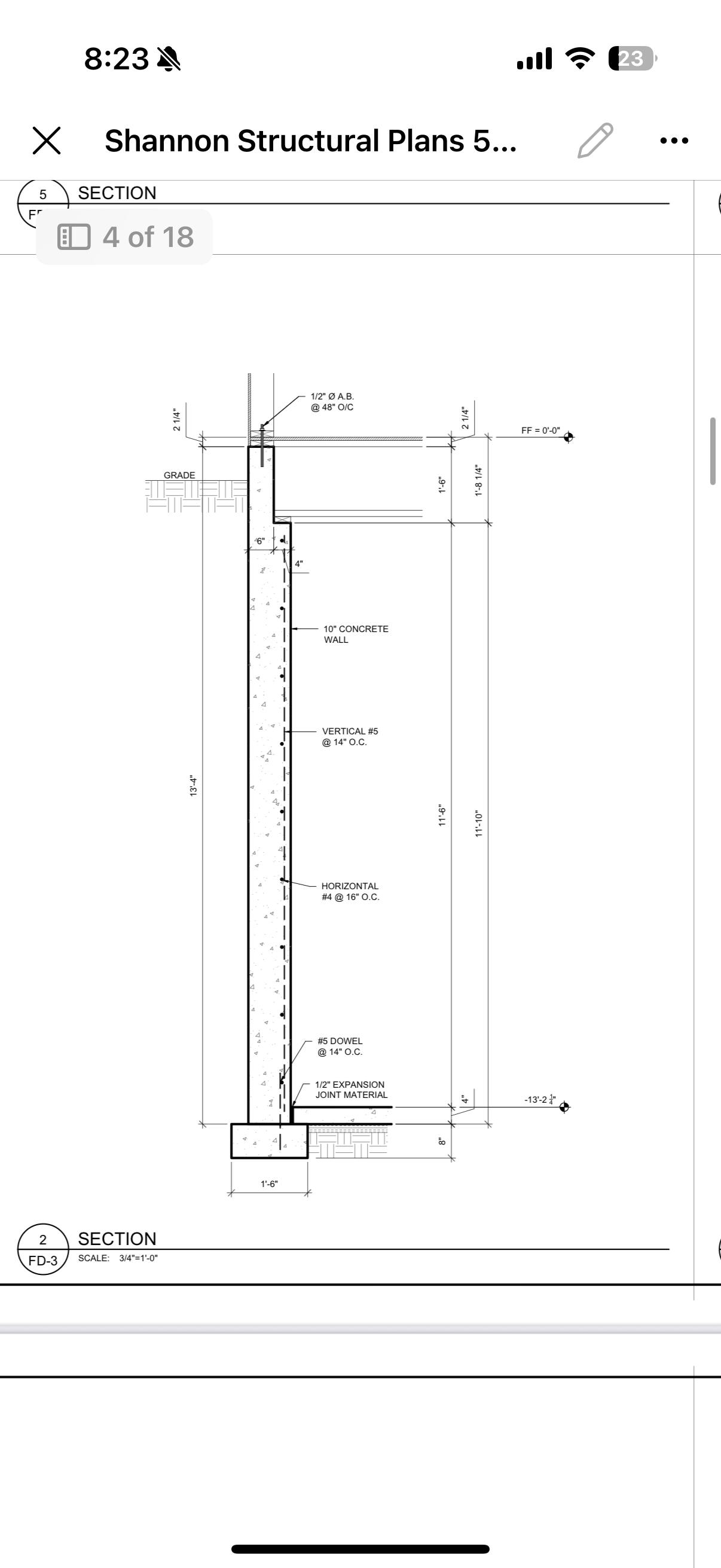

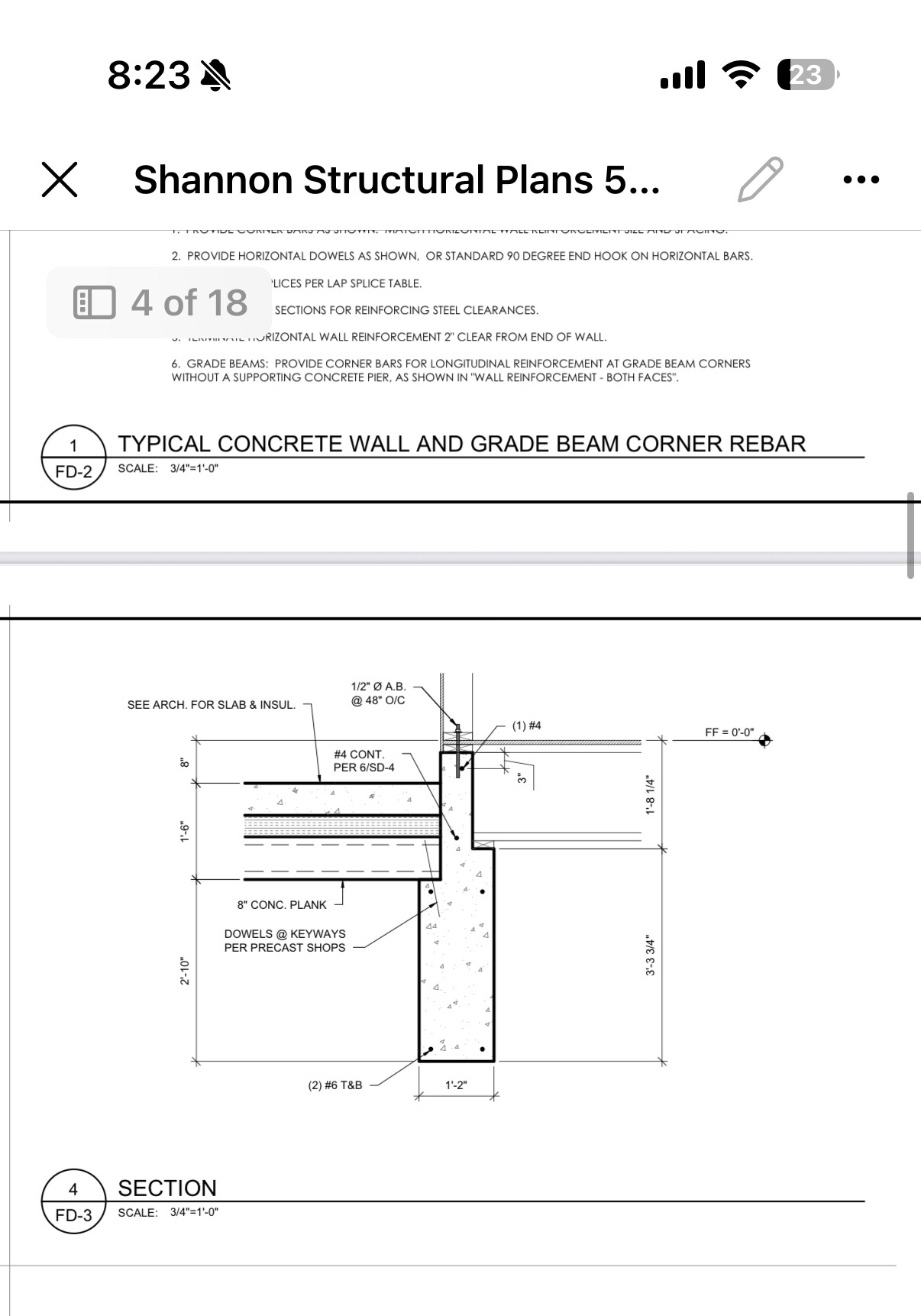

I am looking for the inverse on a brick ledge, where the joist will sit on the foundation wall. See attached .

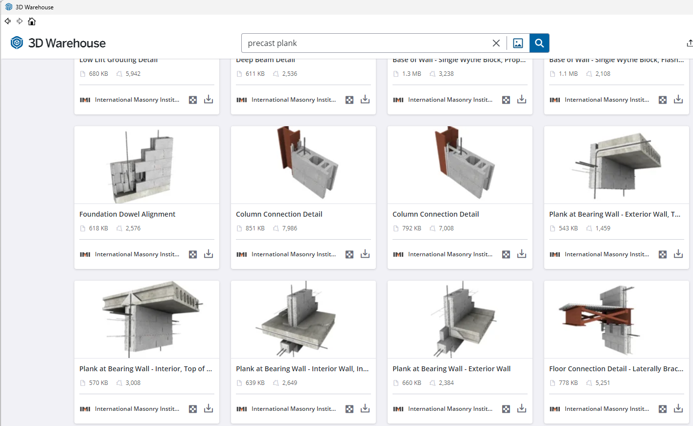

Also found a few details in 3D warehouse that you may find useful.

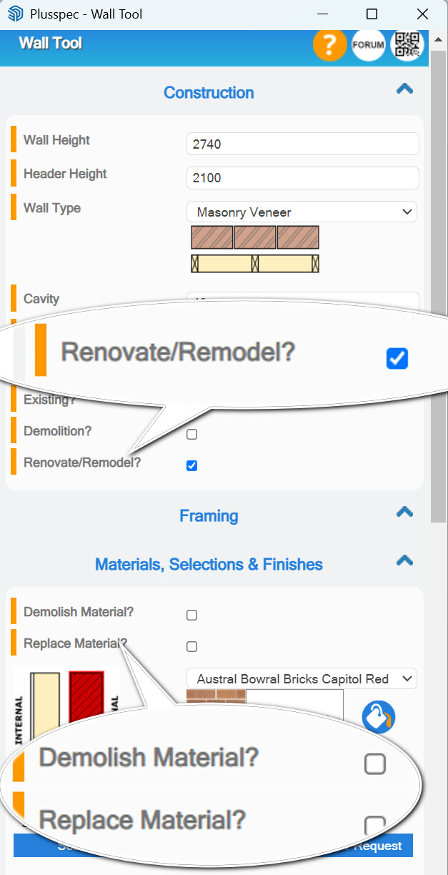

That is a good workaround, Steve, except that if you lock a wall/s type, it will not quantify, so be careful if you intend to use it to estimate.

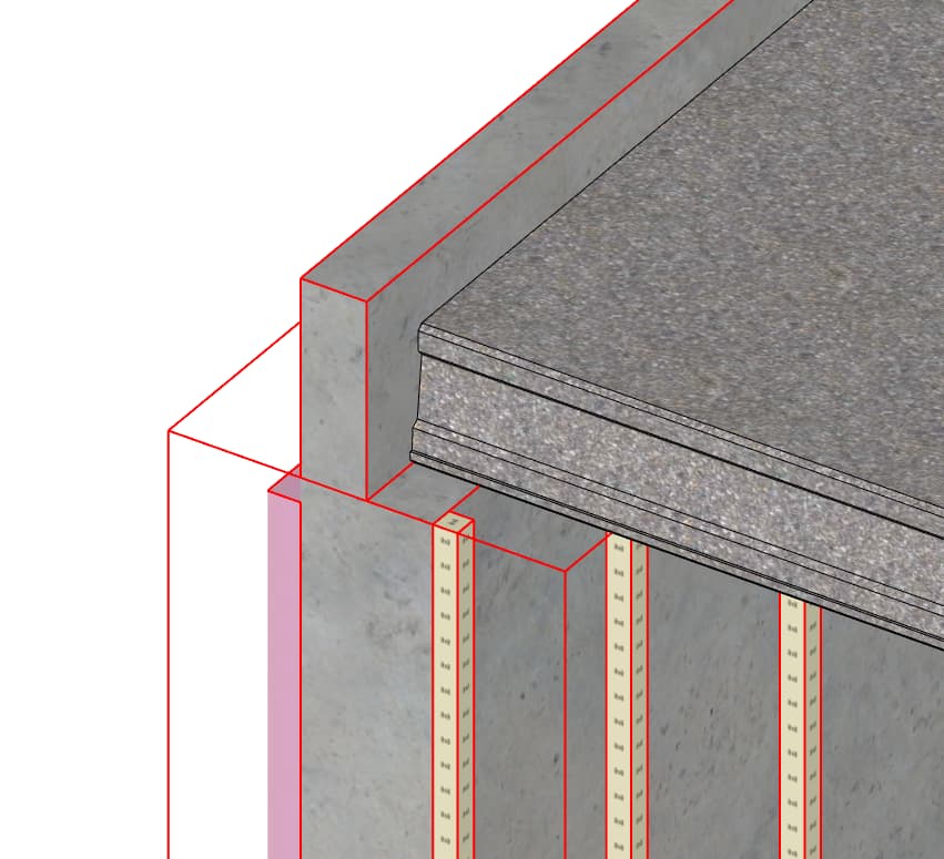

All locked items in SketchUp are not quantified in PlusSpec, except for those selected for renovate/remodel work. See image:

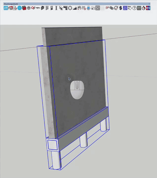

@Cory_W We took your request on board and have created a solution (currently in beta) that enables you to use Steve’s method and replicate multiple walls with one click.
